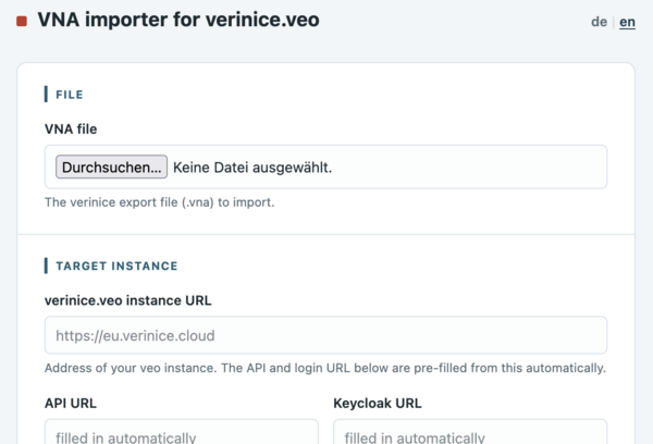

The VNA Importer is here. Existing verinice customers can now migrate their data themselves to verinice.cloud or verinice.onprem. The importer is available as a web service. A detailed documentation is also available.
It is based on the VNA archive format, which all verinice versions export. And it’s that simple: Select a file, enter the URL of the target instance and your login credentials—then start the import. The importer creates a new unit in the target environment and copies the content there—the source data remains unchanged. Multiple information sets can be imported into a single unit, and the process can be repeated as often as needed.

For testing purposes, the importer offers a “Dry Run”: The import runs through the process without writing any data and reports errors in advance. A “Strict Run” performs an even more rigorous check. It’s worth running both before performing a production import.
